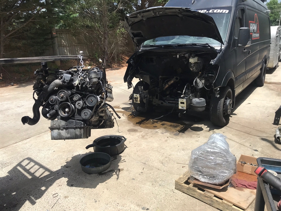

Ok guys I'm new to the sprinter forum but have had my 07 3500 170 for a few years now. I have been thru a lot of repairs and upgrades and at 151k miles it **** the bed. The engine gave a shudder and oil was blowing out everywhere. It appears that one of the pistons either broke or the ring broke and is pumping compression into the crank case.
So instead of beating a dead horse I have decided to do a LS Swap on it. I need reliability and the cost of a new 3.0 is crazy.
Im using a 2013 GM L9H 6.2 and a 6L80E 6 speed automatic.
A little background on myself.
I have a company that specializes in installing LS engines into newer Jeep wranglers. We have a complete system that incorporates the Jeep CANBUS with the GM CANBUS system and makes everything work as designed.
I spent a little time decoding the Sprinter CANBUS system before I pulled the 3.0 out and the messages are very similar to the Jeep stuff I have been using. So I'm pretty confident that I can make everything work as factory.
I have the GM powertrain in the sprinter and am working on some bolt in motor mounts. It fits great and looks right at home under the hood.
I had to use a front sump oil pan because of the design of the crossmember but it fits great and looks like it was made for it.
The trans almost sits in the same spot and will require a bracket to attach to the crossmember and the drive shaft will need a slight modification to work with the GM output.
I will get some pictures loaded up and some details of my progress as this project progresses.
