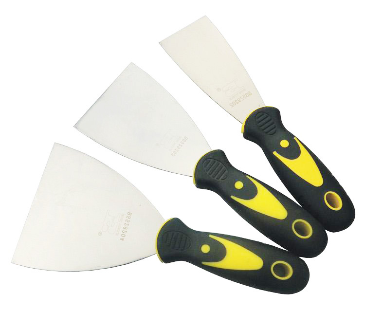

We tried a number of tools/shapes/sizes and a good ole narrow putty scraper worked best (combined with copious quantities of heat gun - to the point things were smoking):
If I could "make a tool" for the job it'd be a super sharp (yet strong) razor blade on a 90 degree handle - with a delron slider on the top of it to keep it from digging into the filet - and a heat gun.
