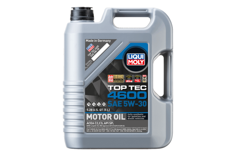

While I'm sure Top Tec 4200 would be just fine, I opted for Liqui Moly's Top Tec 4600 5w-30:
I was swayed by Liqui Moly's own description of this oil: "Designed for use in a variety of BMW and Mercedes-Benz diesel vehicles..." Liqui Moly also clams that it's made with turbos and DPF's in mind.
Don't be dismayed about the MSRP listed on the Liqui Moly website. I got 5-L jugs of this oil from Amazon for considerably less.
BTW, ignore what websites like AutoZone and Amazon say about fitment, especially for a Sprinter. They're completely whack. Just go by what is stated on the label.
After the first change at ~ 10,000 miles, I found that under essentially the exact same circumstances (climbing up to the Malad Summit on I-15 near the Idaho-Utah border), my OM654 oil temp ran ~ 20 °F cooler than it had two weeks earlier with the factory oil in it.

Just picked up some 4200 5w-30 from autozone. It does state the MB229.52 approval, They currently have it on sale for 44.99 for a 5L jug and i wanted to get my oil change done since the valvomax came in and i just passed 10k miles.
I will try and log my oil temps with the 4200 then track down some 4600 and see if theres a difference

Was the ambient temp, wind, and load/weight same?
Yes. It was even the same time of day, and in the same direction (northbound). Same type of weather (sunny and warm), and the load was identical as well.
BTW, I also experienced an overall improvement in mileage of 1-2 mpg. Not much in absolute terms, but measurable, and significant percentage-wise (6-12%).
I've always watched the oil temp during climbs, and while it used to exceed 230 °F at times, the temp never gets that high with the current oil fill.

I would not assume a product on Amazon is genuine.
It's hard to argue with results.
Not to ignore the fact that some amazon sales are actually fulfilled from the manufacturers Amazon Storefront. Not always of course, but not uncommon.
And plenty of legitimate resellers of quality branded products, for example Victron items sold by Bay Marine on Amazon.
I don't think ordering an item claiming to be a specific brand of motor oil, and something that appears to be motor oil coming to your door in a package that looks like the package that motor oil comes in is proof that the contents is the same as that genuine motor oil. An increasing trend in the retail world, in addition to fakery on Amazon, is to manufacture specific, lower spec versions of a brands normal product and sell it through various bulk sales operations, such as Walmart, Target, and Home Desperate. I know this sounds crazy and moronic on the part of the brand, and it very much is, but it is absolutely done anyway... sometimes with the same SKU!
When it comes to products like this, you are buying the vendor as much as the product.
