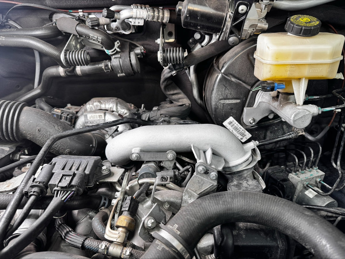

We’re currently developing two Air Intake Resonator Delete options and wanted to share our direction:
Option 1 – Resonator Delete Only
Retains the factory aluminum charge pipe and intercooler hose while removing the OEM resonator.
Option 2 – Full Intake Delete
Replaces the intake path from the turbocharger to the intercooler, eliminating the factory aluminum pipe and intercooler hose. The system connects via a reinforced silicone elbow.
Both options are in the prototype stage and will undergo extensive testing for fitment, durability, and heat resistance before any public release.
Initial prototypes will be produced using high-temperature, carbon-fiber-reinforced polymers selected for under-hood environments.

Hello do you have that file for that 3d print? Or was that hand made?
sprinter.motors
SPRINTERTECH
This is an issue for my 2011 OM642. I've replaced seals and readjusted several times and it is always a temporary fix. Perhaps a new attenuator would hold better but I ended up with a weird 3 hose clamp solution to keep the attenuator attached to the charge pipe going to the turbo and haven't had a problem in years. So have not replaced my attenuator.
Going to keep an eye on this. I may be interested once you finish development.
We are actively testing it. Did the first 20 miles on it today.
