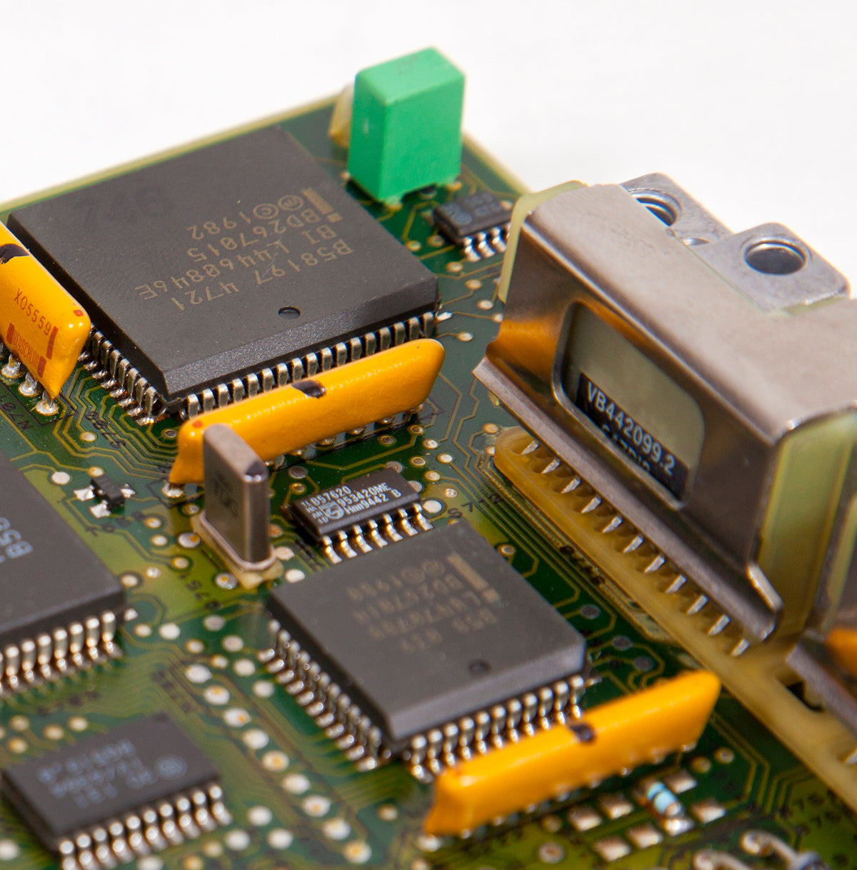

Anyone have the circuit schematic of the ECM (EDC16C2, A6471532779)?
I'm doing some DIY repair but I need to know some of the capacitor values, at least. Specifically for the 30460 pins 56, 50, 49, 48 (measured 100 nF, 47 nF-ish, 82 nF-ish, 39 nF-ish): I'm not sure which goes to which.
